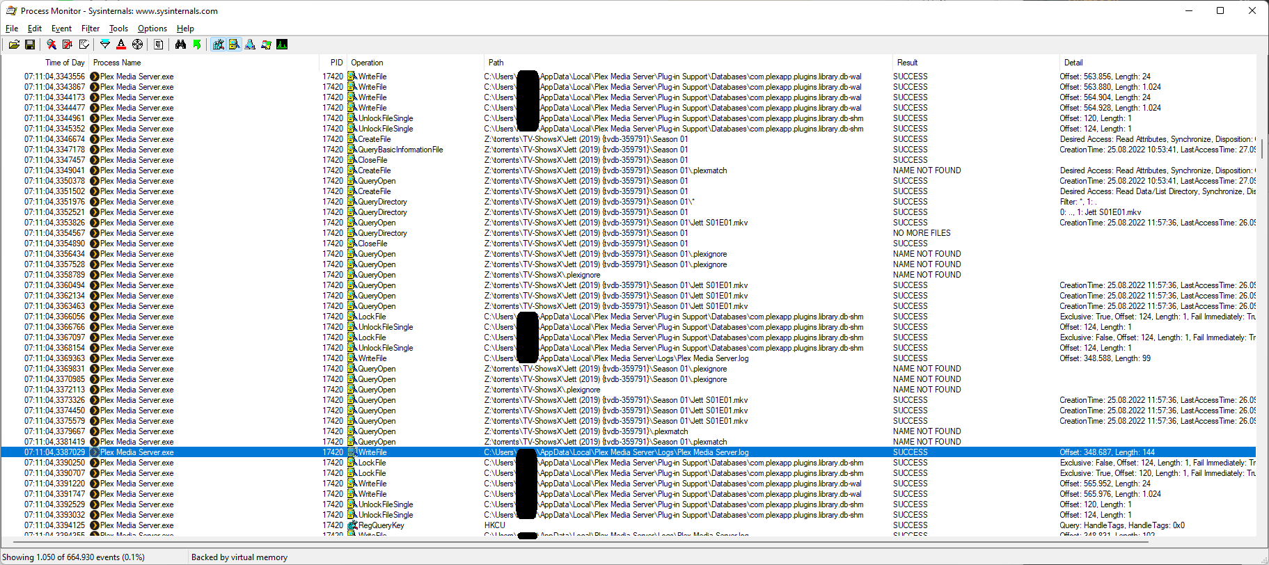

For the fun of it I did a run w/ process monitor running, PMS definitely does and can access that mkv:
I’ve made a stub exe that logs command line and executes ‘orig.exe.save’ and replaced Plex Media Scanner.exe.
For Jett mkv it does not get invoked at all and this is log when kevin mkv is in dir:
[29116] XXX >>> 'C:\Program Files\Plex\Plex Media Server\Plex Media Scanner.exe' '"C:\Program Files\Plex\Plex Media Server\Plex Media Scanner.exe" --analyze --log-file-suffix " Analysis" --no-thumbs --item 96'
[29116] XXX <<< 'C:\Program Files\Plex\Plex Media Server\Plex Media Scanner.exe' '0'
[3568] XXX >>> 'C:\Program Files\Plex\Plex Media Server\Plex Media Scanner.exe' '"C:\Program Files\Plex\Plex Media Server\Plex Media Scanner.exe" --match --type 2 --log-file-suffix " Matcher" --item 96'
[3568] XXX <<< 'C:\Program Files\Plex\Plex Media Server\Plex Media Scanner.exe' '0'
[5332] XXX >>> 'C:\Program Files\Plex\Plex Media Server\Plex Media Scanner.exe' '"C:\Program Files\Plex\Plex Media Server\Plex Media Scanner.exe" --match --type 2 --log-file-suffix " Matcher" --item 94'
[5332] XXX <<< 'C:\Program Files\Plex\Plex Media Server\Plex Media Scanner.exe' '0'
So the question I guess is what can cause PMS to skip invoking scanner.exe ?!?!

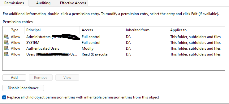

For the OP, it’s interesting that on a new user it works as expeted. I feel that there may be some corruption in the ACLs of these files. Try this:
On the root folder of of your media, in the advanced file permissions window use the change ownership, either select a new principle, can be your self even and check the Replace option
after it processes close out of all the properties windows.
open them again make sure the permission entries look like this at least. you can give yourself full control if you like. and make sure the replace at the bottom is checked before hitting ok

thanks for trying to help but this is definitely no permission issue
there are two things that it is usually when you everything else tells you it’s not. DNS and permissions. and when it’s not DNS it’s permissions. It won’t hurt to try resetting the permissions on your folders instead of dismissing it out of hand
if it was such a problem the old scanner wouldn’t work either…
additionally, adding a TV-Shows w/ these file on a e. g. FAT formatted usb stick has the same problems. and w/ FAT you certainly won’t have permission problems of any kind
