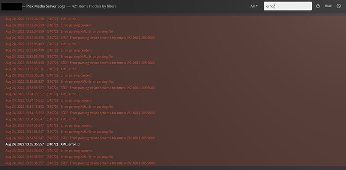

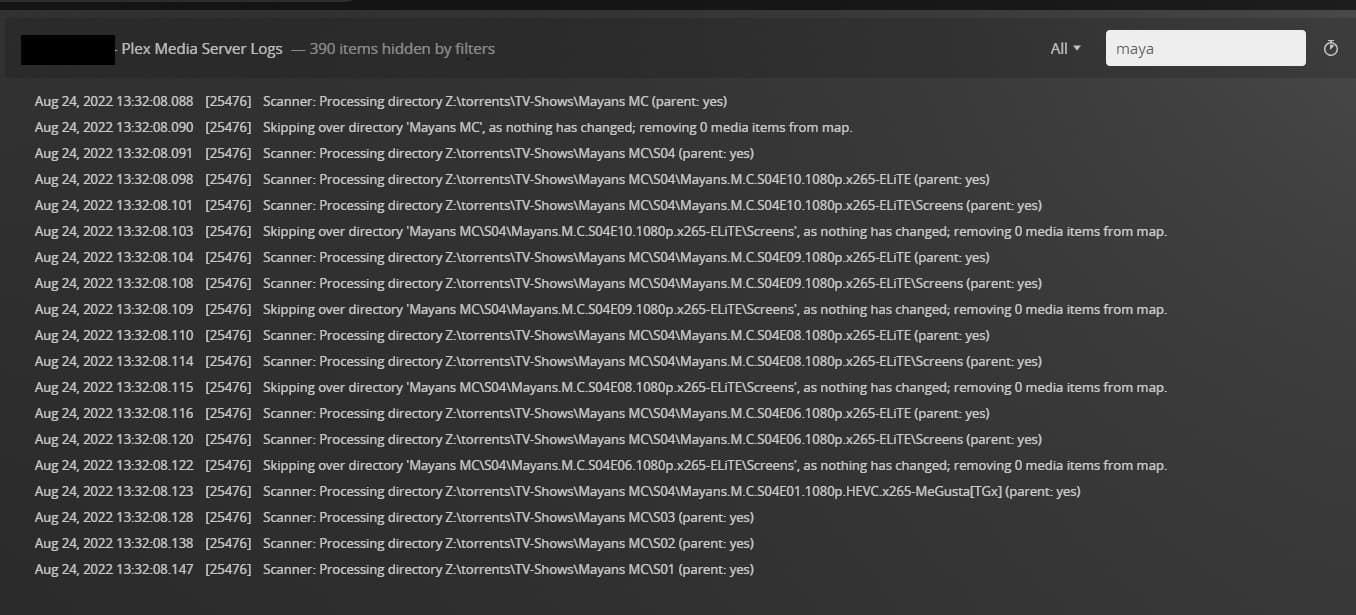

log from a show that doesn’t show up:
those errors that show up (which to me seem unrelated):
Can you please post a screenshot of some of the files that plex isnt scanning? Im 99% sure its a naming issue. Just because your non-standard schema used to work, doesnt mean that support for that format wont get dropped at some point.
Mayans?
  1. Is z:\torrents where the files are downloaded? If so, do not have Plex scan that folder. Move the media into a new folder once the download is finished.
    Scanning a folder with partially downloaded files will cause issues with Plex correctly recognizing and organizing media. It also results in Plex continuously scanning the folder as the download progresses and Plex is notified that the contents have changed.
  2. Rename per Plex documentation then Plex Dance the show.

does not show up in plex after scan:
(windows discards last ‘.’ in file/dir names)
no idea if that’s related but that url is definitely broken
2022-08-24 14:48:20,884 (33ac) :  ERROR (networking:196) - Error opening URL 'http://resources-cdn.plexapp.com/hashes.json'

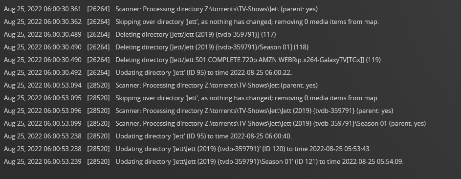

verbose logging, new directory w/ just one file
plus one w/ original filename:
Aug 25, 2022 06:22:19.064 [3652] VERBOSE - Adding file for scanner: "Z:\torrents\TV-Shows\Jett (2019) {tvdb-359791}\Season 01\Jett S01E01.mkv"
Aug 25, 2022 06:22:19.064 [3652] VERBOSE - Adding file for scanner: "Z:\torrents\TV-Shows\Jett (2019) {tvdb-359791}\Season 01\Jett.S01E02.720p.AMZN.WEBRip.x264-GalaxyTV.mkv"
so it seems to find files…
