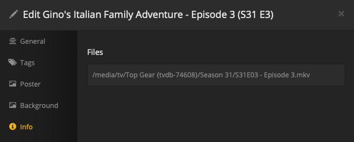

When adding multiple different shows in a short period of time, the first show that’s matched and added works fine, Any subsequent, different, show - no matter what the naming convention - then shows up as a later series of the first matched show. This behavior has only started since upgrading the library to the new scanner, and seems to occur with files added within a short period of time to each other (about 5-10 minutes):
For example, adding the file:
/media/tv/Gino's Italian Family Adventure {tvdb-412299}/Season 01/Gino's Italian Family Adventure - S01E01 - Family in Sardinia.mkv matches correctly.
Adding a subsequent file, for example:
/media/tv/Top Gear {tvdb-74608}/Season 31/Top Gear - S31E04 - Episode 4.mkv
..then matches those episodes as “Gino’s Italian Family Adventure, Season 31, Episode 4”.
I’m at a loss. I’ve added the {tvdb} suffix using Filebot to be more specific about the series; I’ve tried unmatching and re-matching; I’ve tried refreshing metadata - but the server stubbornly insists on keeping the original matches. Sample screenshot below:

I took a closer look at your screen shot.
You are editing a whole season there, not just an episode. So it is completely normal to see all file names of this season listed at once. It doesn’t mean that both file names are associated with the same episode.
Sure, but the issue is that even an individual episode with a well-formed naming structure like below, still keeps getting mapped to an entirely different show. And even “unmatching” at the season level and initiating a new scan doesn’t correct it and remap it.
/media/tv/Top Gear {tvdb-74608}/Season 31/S31E03 - Episode 3.mkv
