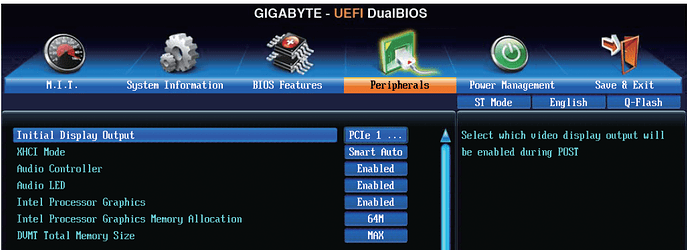

Plex might be using the Intel HD Graphics in the 4790K, which does not support HEVC, instead of the RTX 2080.
Make sure you have the 2080 set as the primary video in the system BIOS.
Example: My Gigabyte motherboard.
Initial Display Output = PCIe slot where graphics adapter is installed.
The PCIe is set as primary device in bios. Tho I think that only changes what displays the bootscreen and is started first.
Good.
It also determines which GPU is used by Plex for hardware accelerated transcoding.
