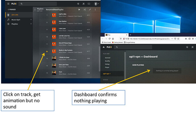

In case a picture means 1000 words, here is a screenshot showing me trying and failing to play using a browser. The orange bars against the selected track are moving in the browser window (but not in the screenshot). The dashboard says nothing is playing. Each time you select a track that fails to play you get a ‘broken pipe’ message in the debug log.
