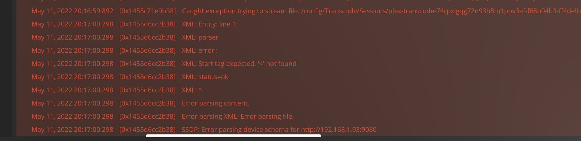

The transcoder doesn’t crash, it fails to fetch the next segment i believe. I’m on Unraid and experiencing the identical issue since 1.24.5.
Heres the log entry when it occurs
Heres the problem, if a video is directly streamed but audio is transcoded it will cause a buffering error, the client does not matter.
Here’s my logs, the time stamp on the first picture should put you around the ballpark.
Plex Media Server Logs_2022-05-11_20-17-35.zip (7.0 MB)
