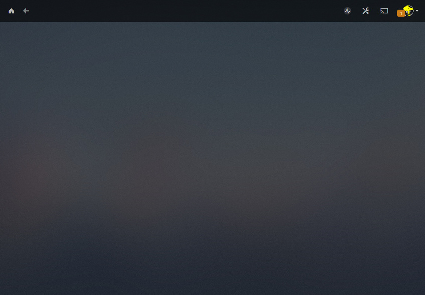

Everything run smoothly till whrn I have launched Plex: I have been recognized with my username and psw but I get a black screen with nothing else.

Now there is one more malfunction: when i try “Check for updates” PSM starts, ask for my type of access (I have choosen email), starts regularly but with a black PSM screen.
Therefore using the command “wrench and screw driver” on top of it I am able to get to the screen where there is “check for new version” command: I can’t activate it by clicking on it.

Those screenshots - they are cropped. They do not show the time or the url - i need both to relate the logs you captured
The 2nd screenshot shows that you have successfully accessed server settings - how did you get to that from a blank black screen?
So need to know what url gave the blank screen ? and I need the logs for the time
What did you click on to get a blank screen? And was it through http://127.0.0.1:32400/web ?
