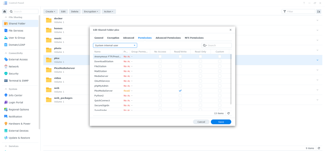

Hello @007fred50 @ChuckPa , maybe you could help me.
Whenever I try to create a new library, I am not able to see the folders inside the main shared folder.
Do you know what could I do?
Best regards.
Hello
you need to set this here:
Step1: Control Panel
Step2: Shared Folder → Create Folder
Step3: edit folder
Step4: Go to Permissions tab
Step5: select dropdown menu (Local Users) → System Internal user
Step6: find PlexMediaServer select Read/Wrtie
now it should work.
wish it works for you.
Bset Regards
007fred50

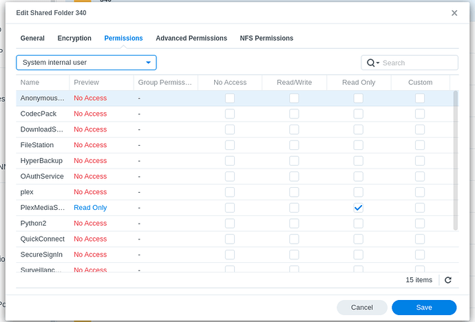

OK..
here’s how.
  1. You have the existing shared folder “Family”
  2. I’m showing you shared folder “340”. You use “Family”
    – Control Panel - Shared folder
    – EDIT the Family shared folder
    – Permission tab
    – Change “Local User” to “System Internal User” (it’s a dropdown)
    – You’ll see ‘PlexMediaServer’
    – Check the box for ‘PlexMediaServer’
    – Click SAVE (This grants permission to the shared folder)
  3. Now we’re going to force all permissions for all media in the “Family” shared folder to allow Plex. (this is a permissions reset)
    – FileStation
    – Highlight Family
    – Right-click → Properties
    – Permissions tab
    – You now see ‘PlexMediaServer’ has Read access to the shared folder.
  4. Check the box in the lower left corner: “Apply to this folder, sub-folders and files”
  5. Click “Save” (this will take a moment)
  6. You will see it “saving” as it applies the permissions
  7. If you’ve already created a library section that points into “Family” all you need to do is “Scan files”. PMS will start seeing the media and adding it.
