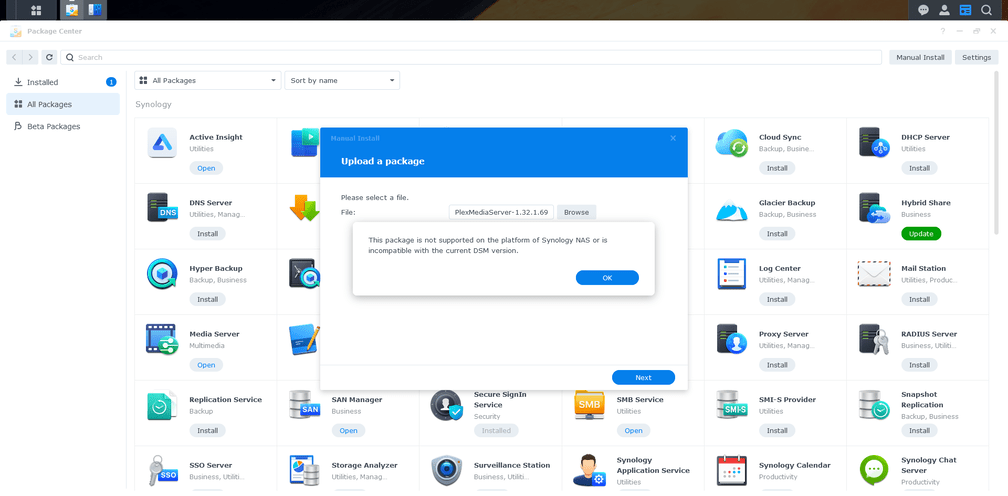

I downloaded a file (PlexMediaServer-1.32.0.6950-8521b7d99-armv7neon_DSM7.spk)
In package center right side (manual install) choose file I downloaded and it says (this package is not supported on the platform of synology NAS or is incomatible with the current DSM version)
I have tried download all files and try them 1 by 1, still same messages.
Can someone tell me why it does not work?

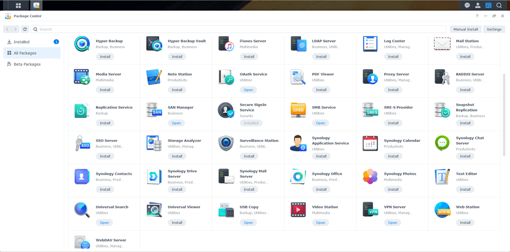

Hello
i can see any other package
So my network works or?

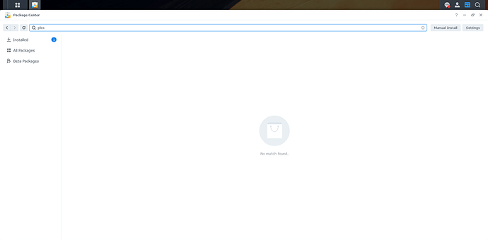

And you cant search for Plex and get this answer ?
Screenshot from 2023-04-19 03-22-27
No plex in search

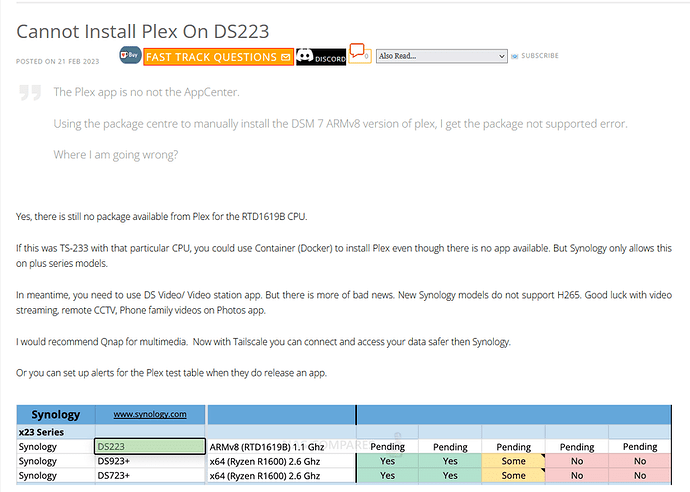

i found this here cpu not supported yet,

Hello,
I try to install manual (PlexMediaServer-1.32.1.6954-56a60573f-aarczh64_DSM7.spk)
but i got this error here.
Can you help me out, or have i wait until some fix bugs?

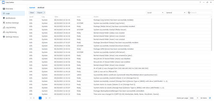

Hello,
i try to find logs on my NAS but can only find this here:
Im doing right?
You’re doing right.

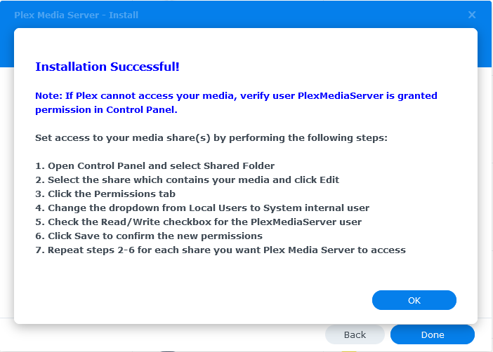

I’ve found what the problem is.
The DS223 has a new product designation inside the SPK file.
I’m now “guessing” what that new designation is :see_no_evil:
Hello,
it works now.
Thanks for that
