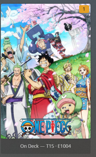

Plex wont recognize episode 1000 (or 1000+) of One Piece
Followed the Plex Dance instruction twice but still same result.
It’s still get scanned as 1 episode with two versions, same as the screenshot I posted earlier.

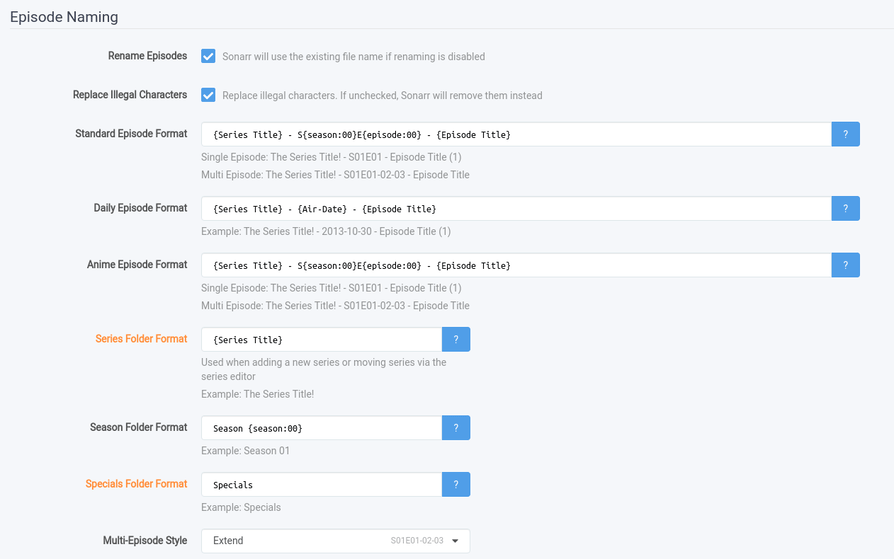

The problem is that Sonarr does not really support that.
I don’t use that software, so I can’t tell anything definitive about it.
But from what others tell about it, you can freely define the naming it uses.
Sonarr does support Plex’s format.
Please consult the documentation for details.
  1. Standard Episode format:
  • {Series Title} - S{season:00}E{episode:00} - {Episode Title}
  1. Daily Episode format:
  • {Series Title} - {Air-Date} - {Episode Title}
  1. Series Folder format
  • {Series Title}
  1. Season Folder format
  • Season {season:00}
Note: to support wider episode fields, change as needed
e.g.
  • {episode:000}
  • {episode:0000}
    Season {season:00}
    These two examples are dependent on Engineering implementing 4-digit episode fields.
