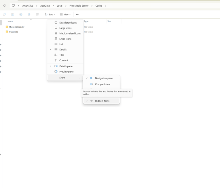

Dive down into the Cache subfolder.

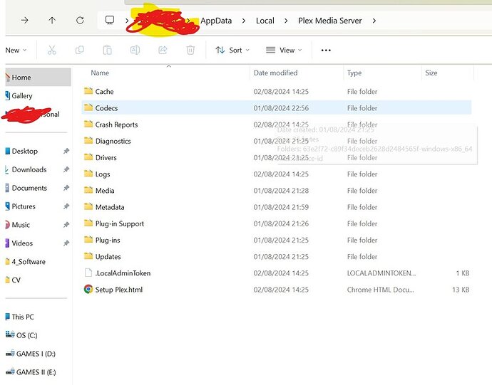

I really can’t find the cert file you mentioned
And this is the screen that is showing me
