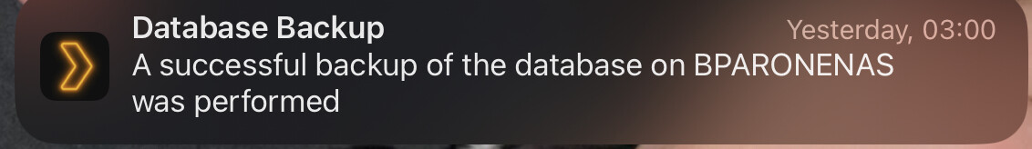

Really? I’ve been backing up to OneDrive and getting alerts every few days telling me it was successful (see image from my phone below).

Oh, you have them setup to backup to another directory ?
I wish PMS would allow me to know this (instead of looking dumb). Sorry

No worries. I’ve been backing them up to cloud storage, only since recently though, just in case anything happens to the NAS.
