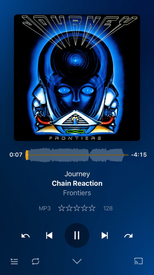

I started the offline playlist and played a couple songs to make sure sweet fades was working, and it was. I then inserted a song to play next. The current song ended completely with no crossfading at all. The interesting thing is the inserted song had no audio analysis info as shown in the picture.
The inserted song ended after its entirety and had no sweet fade interaction at all. The next song played, displayed the audio analysis info and sweet fades continued.

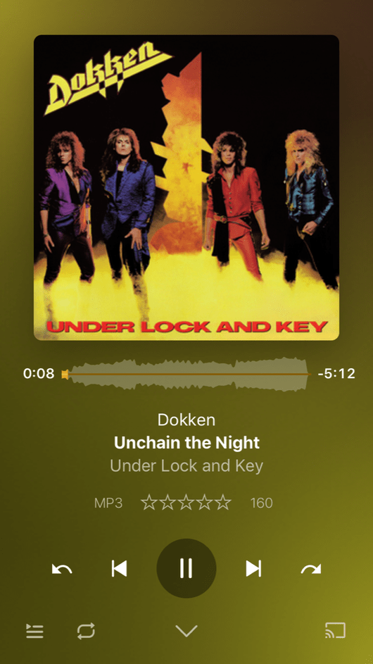

I then stopped the playback, went to the same playlist but began playback from the server and not the download. After a song or two I inserted the same song to play next. This time it contained its audio analysis info as it always had.
Interesting the bit rates are reported differently despite being the same file being played 10 or so minutes apart.
