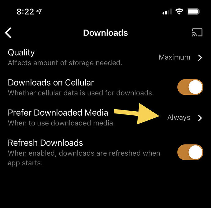

I’m playing the playlist from the Music library tab. I’ve downloaded the playlist and I have the setting set to always play downloaded content.
So I guess that means that the app ignores this setting when you are on the Music library tab? I just thought that the app would first check to the downloaded content area before attempting to fetch the music from the server. Ok, I’ll just make sure I’m on the Downloaded content tab from now on, I guess. What I don’t like about that is you have to scroll all the way to the bottom to see your playlists. The content in the downloaded area is not organized like it is in the music library tab.

  2. i verified i had the settings you have

the only reason i can think of why you wouldn’t be seeing this is because you downloaded the playlist a long time ago. for the feature to work (preferring downloaded media) you have to have downloaded it with the last few releases, as it adds some required metadata to the download.
