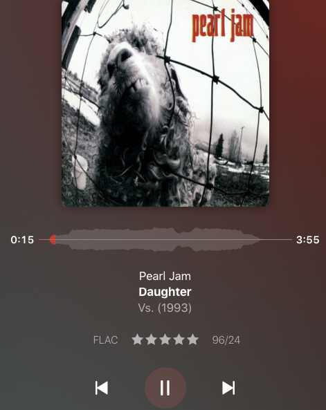

Also depends on if you have Plexamp set to strict sample rate matching, smart, or disabled. I don’t remember what the default is.
Check your settings in plexamp settings => audio output,=> sample rate matching=>, put it on strict and it will change bit depth and frequency on each track. I only have 96/24 that is my highest res file and I know it does it to that rate.
Screen Shot 2023-05-02 at 2.52.33 PM
