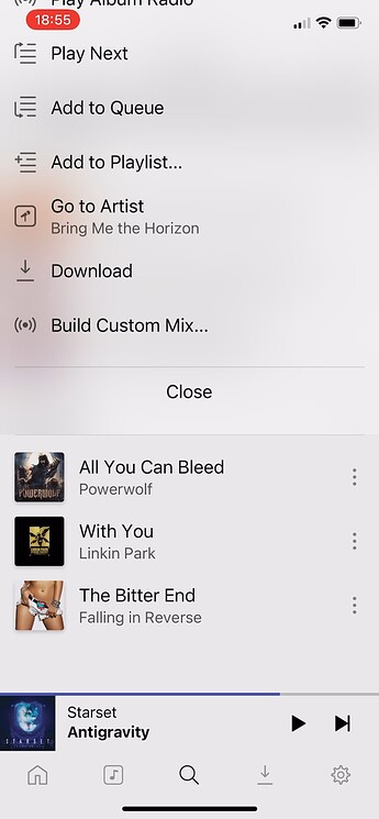

OK, so I think I see what’s going on here, based on your video.
The context menu is coming up and then flying off the top of the screen (see screen capture below):
So you’re left with a hidden context menu, and somehow the background can’t be tapped to dismiss.
However…I have no idea why that’s happening, and I can’t reproduce locally on a few different devices.

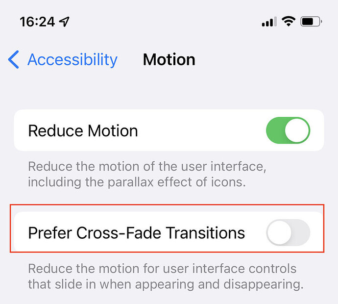

I had “Prefer Cross-Fade Transitions” on .. not sure why tbh…
I turned it off and now it seems to be working … :person_facepalming:
Might be something about that setting that impacts the behavior of apps …
Wow! That is really random :joy: I will make a note to see if there’s anything we can do to make it work with that enabled.
