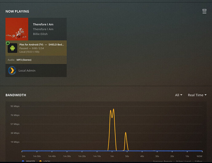

  1. Open Plex
  2. Navigate to Music
  3. Select a track within an album (plays fine)
  4. Select another track within the same album (plays fine)
  5. Navigate to another album (while the previous track is playing in the background)
  6. Select a track (fails to play)
The album art for selected track from step 6 appears on the Android TV Plex player but Plex Server Dashboard still shows the previous track (and is counting as if it is playing). I waited for a few minutes for the track on Dashboard to get to the end and when it does, it skips back 20 seconds then counts again to the end and finally disappears from Dashboard but my chosen track never plays or appears on Dashboard. The same tracks that do not play will play if I exit and re-enter the Album.
P.S. The tracks/albums are chosen at random - don’t judge me they are just tracks for testing :wink:

the player retries if disconnected, and continues to buffer in the background.
if you’re still seeing dropouts, either:
  1. server can’t transcode fast enough
  2. network connection isn’t fast enough
please post plexamp logs right after you see the buffering and we might get a hint.

  1. Open Plex
  6. Select a track (fails to play DASHBOARD sits on 0:00 forever / No errors in log)
  7. Getting out of the Album that fails to play and going back into it again usually works and the music plays.
I do not agree with it being a network issue as I can without a problem view Movies with a 90Mbps bitrate and they pretty much open instantly and never buffer.
LAN is cabled, both Shields gigabit, NAS 4 gigabit with HP ProCurve switch in between.

Thanks for the clarification, and that makes sense.
Any chance of app log right after the playback?
Plex App 8.12.1.22702 (73b01953)
Android 8.2.2(32,6.509.0)
Did a fresh re-install on my 2019 Shield just to be sure and captured the logs as requested.
Played 3 song from different albums, when I got to “Why would I Stop - Detroit 2 Big Sean” the Plex App crashed/restarted (how ironic)
Then again I played approx. 4 songs from other albums and then “Disclosure - Energy (2020)” it sat there not playing.
shield_bedroom_logs.txt (796.5 KB)
from the errors in there, it looks like it’s having trouble playing some of the files:
01-28 18:18:26.760  e: [Treble]: BASS: Error [ret = BASS_StreamCreateFileUser((DWORD)STREAMFILE_NOBUFFER, flags, &proc, context)] - 41
i’ll pass the logs along to the android team.
@elan I think its important to add; the files which do not play the first time around, will usually play if you exit and re-enter the same album.
in that case we’d just use a local player so that makes some sense. i think the bug was fixed in subsequent versions of the player so i’ve asked that team to work on upgrading it.
