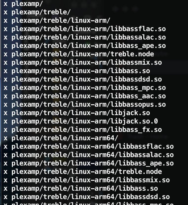

Did anyone have to do anything other than get node 12.22.12? I’ve got the right node, but I’m still getting
Error: /home/plexamp/plexamp/treble/treble.node: wrong ELF class: ELFCLASS64
This is with the latest 4.4.0 build just downloaded yesterday.
Sounds like you’re trying to run a 64-bit Plexamp with 32-bit OS?
I misunderstood the above to mean that it now worked on the 32-bit OS. I have ARMv7 with hardfp. Is there a different download for 32-bit, or am I misunderstanding completely and need to install the 64-bit OS on the RPi4?
It should work on 32-bit as well, I’m not sure why you’re running into a mismatch.

This determines which set of libraries are loaded from plexamp/treble/
$ /usr/local/bin/node
Welcome to Node.js v12.22.12.
Type ".help" for more information.
> process.arch
'arm'
That doesn’t have the file treble/treble.node in there. You must be using an older version of Plexamp.
You were right. Although I’d download 4.4.0 on my PC, when I came to get it onto the Pi I copied the link from your pinned post, and that gave me 4.2.2-beta1c!. Went and got the right one, and it’s running.
