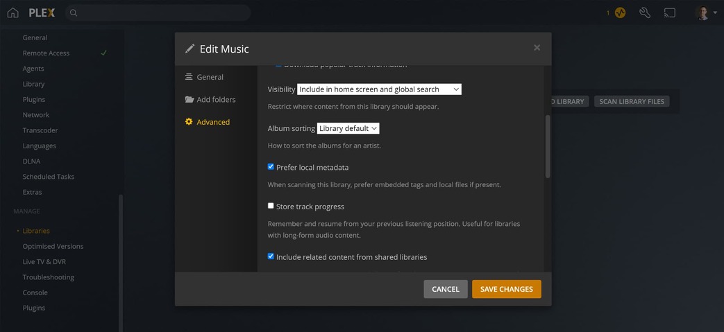

It sounds like you might have the “Store track progress” option enabled, found under advanced library settings. This option is intended for libraries containing non-music audio, such as audiobooks, and should not be enabled for music libraries.

Sorry, it’s all or nothing right now (it would be a fairly arbitrary cut-off point).
Give that Plexamp resumes a play queue in the right spot, you shouldn’t really need that “Store track progress” unless you want to come back to the mix days later and resume it, e.g.

Hi, I have a fully music-based collection and get the same issue multiple times a day with Library radio functionality. I’m probably being silly, but I can’t find the option for “Store track progress” in my Windows 10 or Android 10 Plexamp settings. I’ve been though all options including the Advanced section, but not seeing it. It would be great to fix this, as it’s my only annoyance with the app at the moment, everything else is running great!
It’s not in Plexamp.
It’s in the properties of your music library, when edited using the Plex web app or Plex for Windows/Mac or Plex Media Player.
Thanks, I had been looking on the server too, but had been looking in the wrong place. I’m still a Plex novice! :slight_smile: I was looking in Settings->Library->Advanced Settings, instead of Manage->Libraries->Edit Library
Found it now, so hopefully issue solved for me, thanks again.
