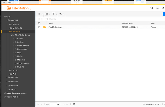

I was having problems with “Vol1” not showing up and being able to access permissions… I stopped PMS, deleted PlexData.
Under Shared Folders, Create… Create Shared Folder… named it again, then I “Enter Path manually” and found plex media server dir.
I believe it worked. PlexData now has 19.93 gigs in dir… Is that bloated?

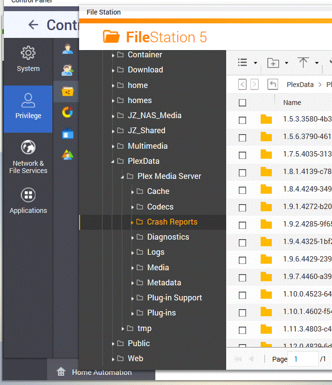

@ChuckPa, From screen shot does the dir look correct? I have crash reports from 2017 ish. PlexData dir looks bloated. are there tips to clean up PMS( been on QNAP for about 5 years)?

@ChuckPa… Great work on PlexData for QNAP… been scratching my head on how to! Seems like I got right?
It should look like this.
To undo any configuration errors the previous has done.

    b. I create the PlexData share on the “Default System Volume” (whatever that is).
  4. You still go to Control Panel - Shared Folders and grant permission for FileStation access and network access (it will be invisible to everyone until you do so - even admin because of how QNAP works)
I advise against manually creating the share because, if the package were ever to move (“migrate to”, or QNAP changed things), the share definition would be invalid.
If I’m understanding you right, you’ve done is right but is the keeps part of PMSLibShare. You’ve created a share which points directly at the destination. I create a shared folder on the default system volume and, in it, create a link to Plex Media Server which is really in the .qpkg/PlexMediaServer/Library directory.
This was created to supersede PMSLibShare by supporting Volume migration automatically.
