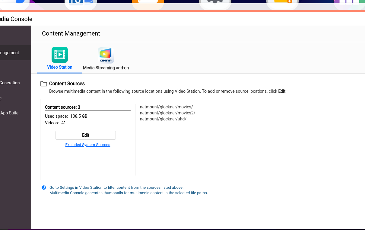

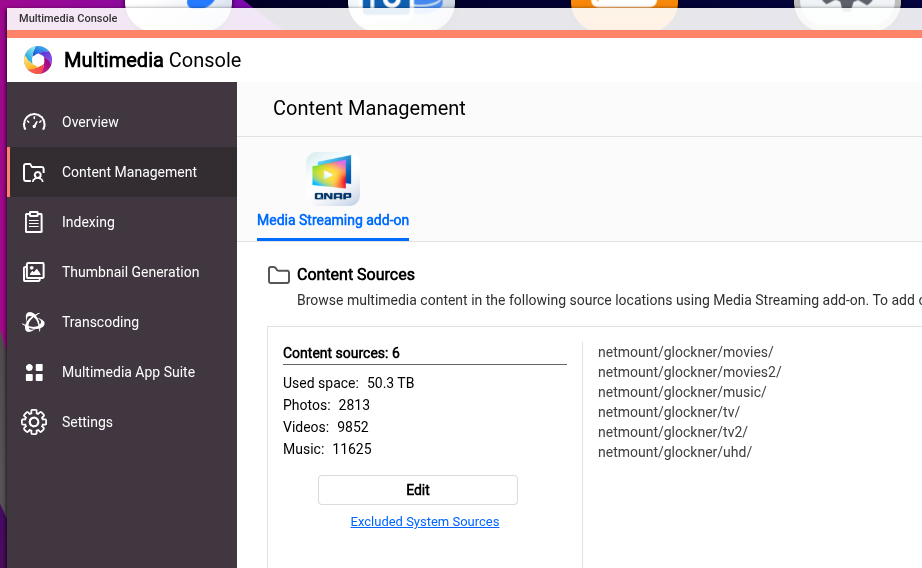

  5. I have a network (NFS) mount of the big nas on the TS128 at the netmount shared folder. Here are all the directories available to the TS128
  6. I tell Multimedia Console to look there.

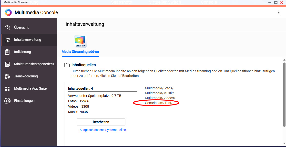

I tested your solution, but here too the folder .@__thumb is created in the media file directory.
Are you 100% certain the QNAP is creating them?
Might it be your WinSCP client?

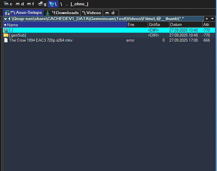

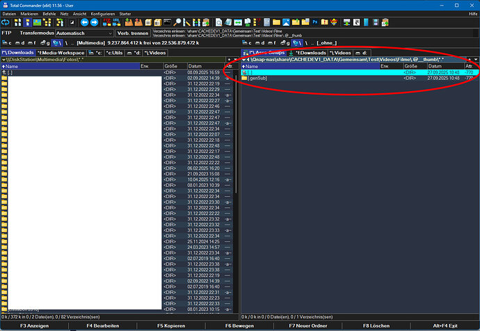

Yes, I am sure! Here is the content of this folder:
The folder .genSub is empty. .@__thumb folders are created if you create thumbnails.
The folder .genSub is empty. .@__thumb__thumb__thumb__thumb folders are created if you create thumbnails.
If you open the media folder using FileStation, you get this result:

Here you can see I use three network-mounted folders and nothing in /share/Multimedia
