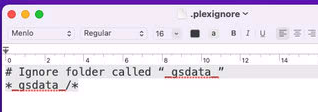

I have a hidden systems files folder (called " gsdata ") inside my primary Photo Library folder that I cannot delete for various reasons. Despite the folder being hidden, Plex picks it up in the scan and displays it as a folder in my Photo Library. I want to use “.plexignore” so that this sub-folder of my Photo Library is ignored and not added to Plex. I have tried all the combinations of .plexignore that I could find online but after the scan the .plexignore file is automatically deleted and the folder remains in Plex. Can someone please advise the correct way to create and write the .plexignore file so this folder can be excluded? Thank you.
Screen Shot 2022-08-14 at 09.59.57
Screen Shot 2022-08-14 at 10.00.14
Note that I have also tried adding the .plexignore file directly INSIDE the " gsdata " folder I want exclude using the “.” and “*” wildcard but it doesn’t work.
Your placement and contents of the file look correct to me. What concerns me is that the file is getting deleted. I haven’t used the .plexignore file in a while, but I’m pretty sure Plex doesn’t delete it. So I’d be looking for whatever is doing that. Could an antivirus program be quarantining it?
Thank you for the reply. I don’t have an antivirus program on the MacMini. Also, what’s very strange is that only the .plexignore file saved inside the master Photo Library file gets deleted. When I try to add the .plexignore file using the wildcard inside the gsdata folder itself, it does NOT get deleted. So it’s definitely the Plex scan that removes the .plexignore file. I guess it’s good that Plex is at least recognizing that the file is there but isn’t acting on it.
So my entry text of: # Ignore folder called “gsdatagsdata/ is correct? I saw some examples that used an additional underscore (_) prior to the folder name to be excluded; so in my case it would be “_gsdata” - could this be the issue?

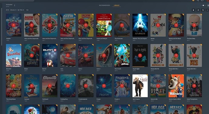

My Animated library before applying .plexignore

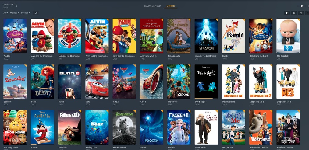

My library after:
  1. Create .plexignore
chuck@ds418:/volume1/Animated$ cat .plexignore
# Ignore MKV files
*.mkv
  1. Scan Files (Empty Trash is turned OFF)

Thank you @ChuckPa. Unfortunately this directory gsdata is created by a third-party sync program called GoodSync and I cannot remove it. I wish I could but I can’t and that’s why it’s hidden by default…yet Plex is still picking it up. Your example above is helpful but it relates to ignoring mkv files. Would it be possible for you to please type out the example of ignoring an entire directory (folder)? It would be most helpful.
I edited my .plexignore file at the moment to the following based on your suggestion above (see screenshot).
Screen Shot 2022-08-15 at 10.57.42
I removed the / and it still doesn’t work and the gsdata folder is still in Plex, HOWEVER the .plexignore file is no longer being deleted after the scan (@Volts).

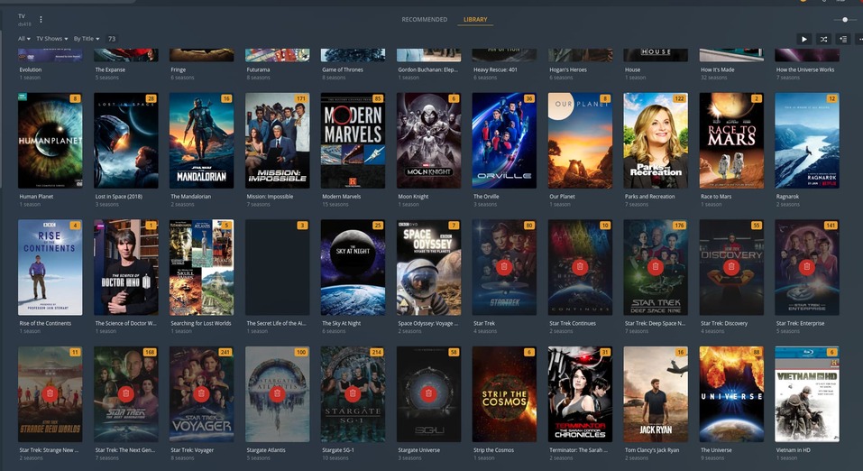

I have an example for you:
In this example, I’ve opted to show selective ignoring of Star Trek and Stargate
Before:
.plexignore contents
# Ignore Star Trek and Stargate entire Series which are in TV.
Star*/
After: (notice I have not clicked “Empty Trash” so you can see what will be removed/ignored)
My folder structure here:

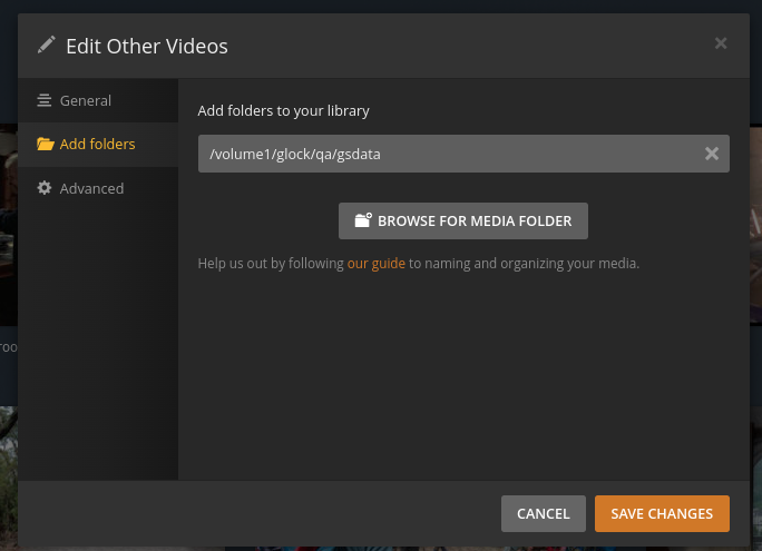

  1. Created an Other Videos library section which will simply grab ALL video files which aren’t ignored.
  2. When the library is finished, there are only 20 video files.

_ gsdata _/
/Volumes/Mega Bisa Photos + Music/Pictures Library$
  1. I ran the GoodSync scan again, which caused the hidden systems folder “_ gsdata _” to reappear inside the Pictures Library top folder.
  2. I then re-ran the Plex directory scan on this Photos library and the erroneous “_ gsdata " media folder has NOT yet reappeared. I have been testing this and re-running the Scan Library for the past several days and the " gsdata _” media folder has not shown up in Plex.
I am not sure right now if it was my temporary manual deletion of the hidden systems folder or the .plexignore file that solved the issue. If the issue appears again, I will update this thread.
