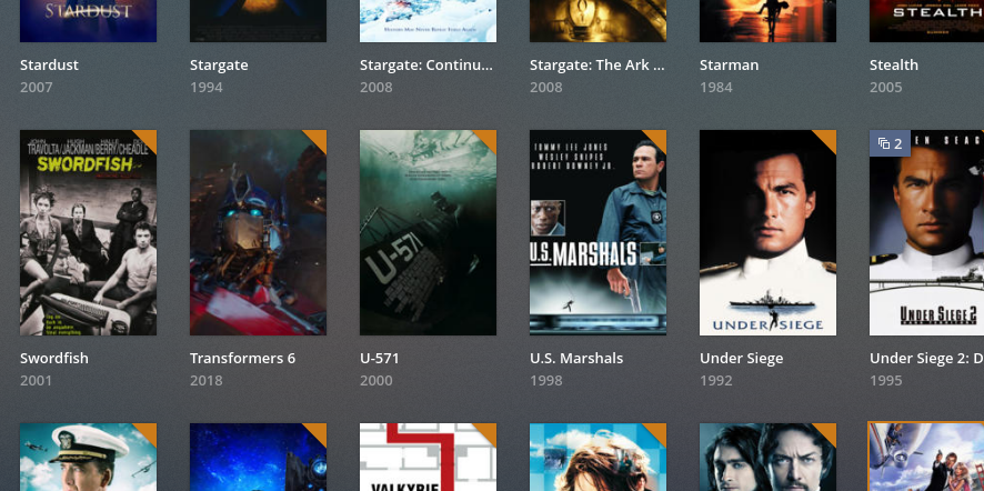

Please observe below with .plexignore in use and without
With (Transformers 6 is the movie “Bumblebee (2018)” which does have incorrect metadata)
Without (Normal) - Below see PMS readding the media

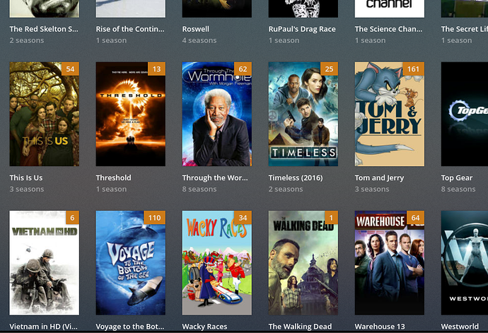

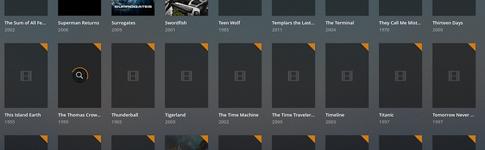

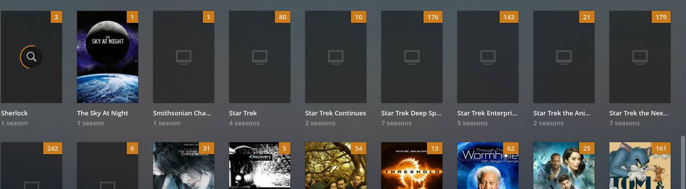

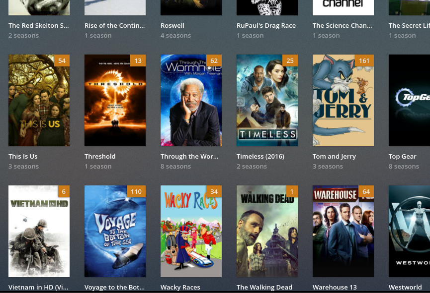

Before:
After:
As you can see, any media file matching the regex S* has been removed
EDIT: Addendum. See it now automatically repopulating automatically when .plexignore is removed.
