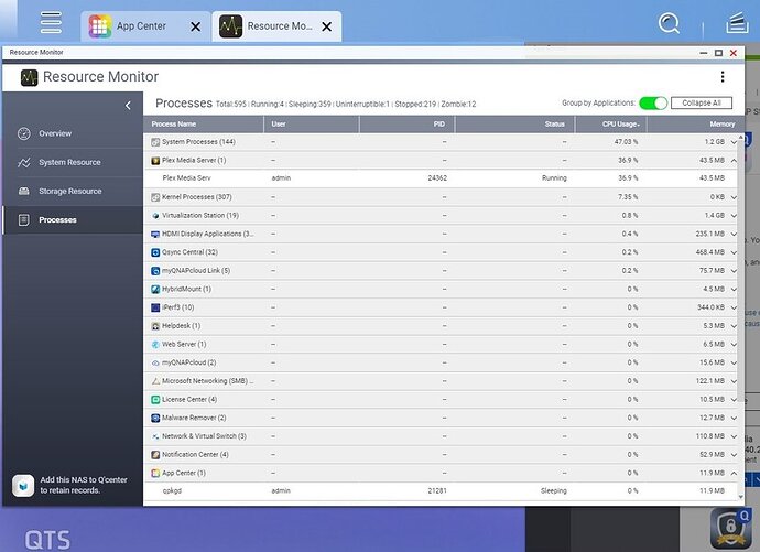

One thing to check, when do upgrade, if it’s taking Plex server a long time to become available via the web app, is to check if the plex media server process is running and taking lot of CPU. If so, it is doing something. If it’s “sleeping” and still not responding, that’s a bad sign.

My DB has been constructing for more than a day.
The size is 10TB
