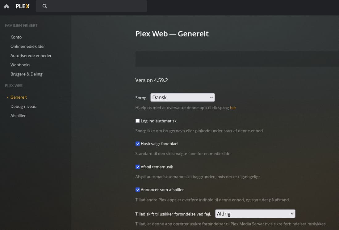

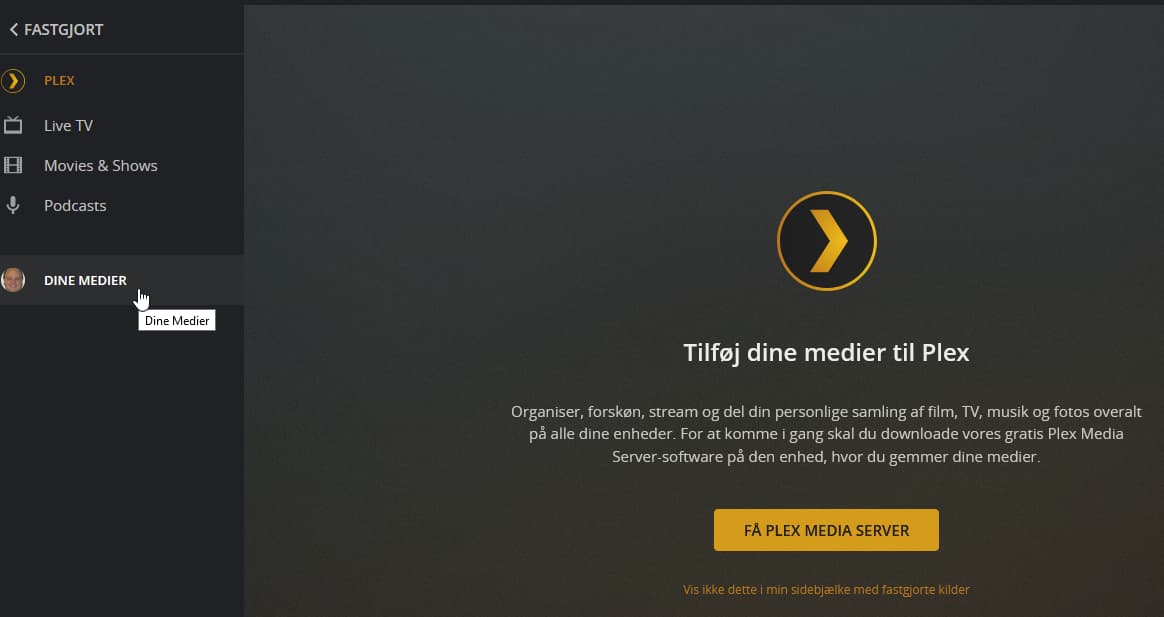

If I go to the IP:32400, I first get shown a login with all my local accounts.
I then log in with the one that is administrator, and then I just see this:
If I go to settings, I see this:
I tried fetching the debug from within the webinterface:
But it’s too big to be pasted

If I go and try to add it, I see this:
It’s really weird.
Try clearing your browser cache and cookies so that your using an empty browser. Think that is why you can’t get to your server using the locally ip.
I’ve tried using chrome instead of my usual firefox, and clearing the browser.
I get a login to the plex account, but other than that it’s the same :frowning:

Hi @ChuckPa
How do I turn it on? I don’t see the server settings as I posted previously.

EDIT: I’ve now tried installing plex on my windows desktop, which is a stupid installation, but just for debugging. I see this URL for it:
http://127.0.0.1:32400/web/index.html#!/setup/52d6bb901f99163222xxxx
And I can set up the server, but I don’t want to use this powerhungry Windoze box for plex.
In this I can see all the server settings etc. that I don’t see even on a newly installed linux box with plexmediaserver_1.24.0.4930-ab6e1a058_amd64
