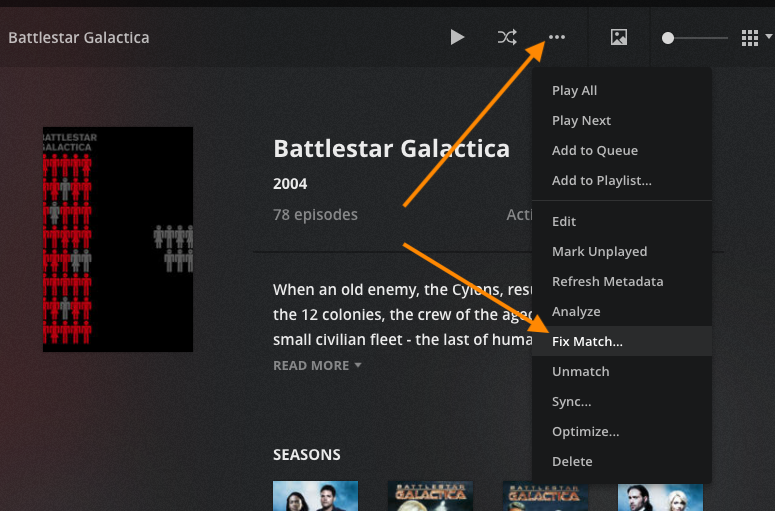

Fix match is at the show level not the episode level. I’m not clear if you are talking about EPG data or metadata from a manually added episode. What is the agent you have set up for your TV library and how are all he secondary agents arranged.
I checked both episode level and show level for Fix Match and it doesn’t appear at either spot. Also I’m not using agents at all - I just added the DVR and selected shows to record. I’m using an HDHomeRun box to record and use one folder to organize all of my recorded television programs. The process seems to work fine with other shows, just not these two.
If you are making recordings it saved to a library. Libraries use agents. Edit the library an you can see what main agent it is using. You can then look at the agent settings and see how the secondary agents are set up.
Fix match is here.
Found it. Gonna try to update it manually myself.
