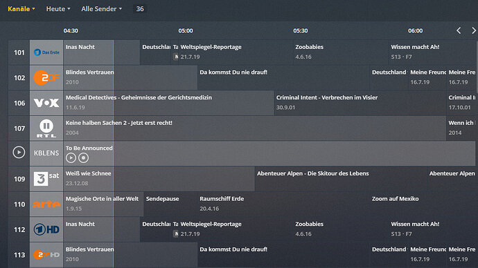

Channel is: Kabel Eins (channel number 108) - tuning to that channel works okay / EPG shows “To Be Announced”

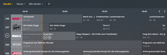

Channel is: Welt der Wunder TV (channel number 505) - tuning to that channel works okay, EPG shows “program of Welt der Wunder”.

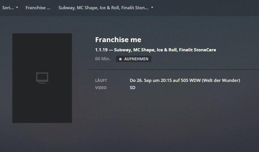

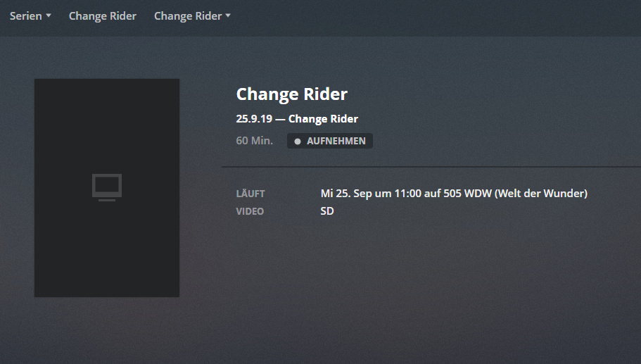

But if I say WDW is now showing airings… these airings do not show ANY metadata.

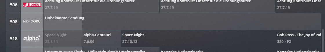

It appears that the SD version of “N24 Doku” - on 508 is showing program data
could you confirm
Do you mean no posters?
I can now confirm this. It wasn’t the case when I replied last time. Nice

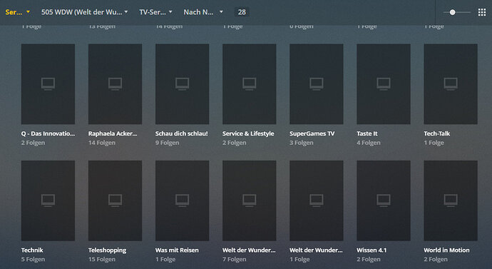

I mean the following:
(a) No posters…

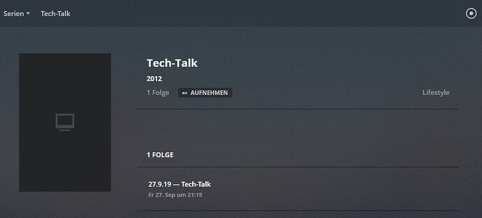

and (b) not much content data on the TV show level (like summaries) with most of the shows not being present on other channels… examples:
… or on the episode level:
… even if the episode title is different from the TV show title in rare cases, no episode summary, etc…
