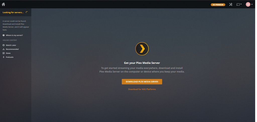

Looking for some help. I have been using PMS as a service for a few months and i’m loving it except for one issue.
I cannot access my server from the same machine that has PMS installed. I just get this :
But I can access it fine from any other device.
Any ideas?
I’m running Windows 10 pro.
