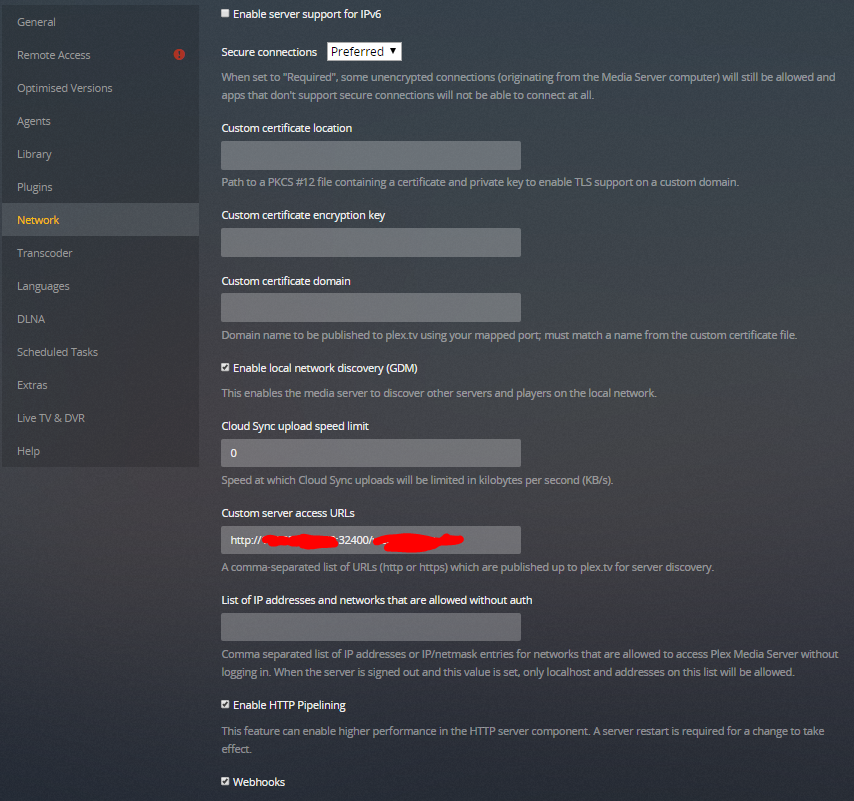

my server settings are as follow :
the issue is simply before i could watch this now no more and i see see that my server “max” allocated bandwidth is around 10mbps when i can deliver 40mbps

EDIT - also, the server setting screenshots you show me show a “RED” icon next to remote access.
You could be playing indirect, limited to 1mbps for non-plex pass users (2mbps for plex pass)
You likely have remote access issues.

so yes i’ve always had this my point on that is that i’m running behind a VPS from OVH and that the server does not show as accessible through that IP and port but in did is or not ?!
When at https://plex.tv/web, does the server name at upper left have ‘indirect’ under it?
From VPS, canyouseeme.org - external IP - port - check.
Both help tell you the answer.
