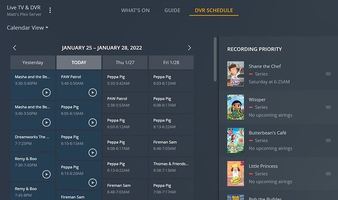

One thing I do notice; even after deleting both the EPG db files and removing the DVR from Plex and adding it back in it has retained the old recording schedule, so it’s presumably not removing all of the DVR related files. I’ve uploaded a screenshot of what the DVR schedule looks like even after doing all the above and not creating any new recordings;

The scheduled recordings are stored in another table in the database. Some appear to be from before the switch to gracenote EPG and need to be deleted and recreated. Others are pointing to a storage location that doesn’t exist or is not writable. Do this for anything that isn’t recording or at least go through each scheduled recording and re-select the library location.

Ah, yes…! It seems I’d forgotten I’d moved the location of recorded TV to another drive a few months ago and forgotten to repoint them to Plex (as the DVR hadn’t been working!)
OK, so they now have the correct paths and should hopefully record (looks like the couple that were pointed to existing locations did work last night, so that’s positive).
