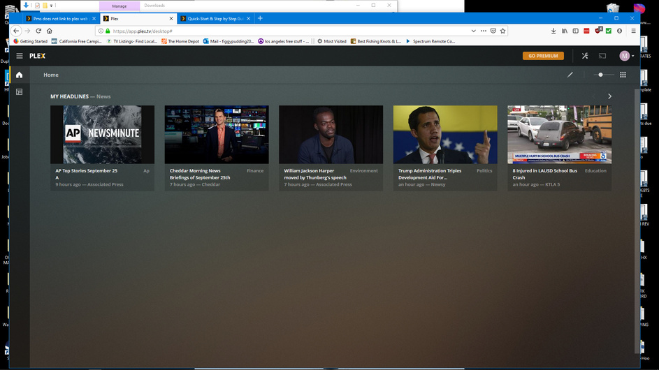

OK first capture is plex home when I went to the first link

Also your above screenshot doesn’t show you using this URL:
https://app.plex.tv/desktop
Please try that URL.
My choice is to open or open as administrator. No install choice offered. I used open as administrator. The screen cap for the link you suggested. doesn’t insert here. It shows options home. news and more which opens to choice of my media which upon being opted returns to the PMS downloads request. PMS is not recognized inside this page.

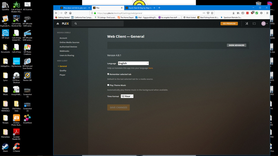

Can you do this: go to https://app.plex.tv/desktop and then click on the Settings on the upper right? It looks like a pair of “tools”, just to the right of “Go Premium”.
Done .
Sorry, screenshot? :slight_smile:
