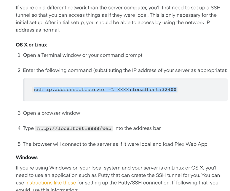

now i understand that is not a “supported” IP range to “claim” a Plex server so i have to SSH to host IP. To do this i’m using OS x Terminal which will allow me to execute the following command, which i found on the plex web site for such situations
On a Different Network
If you’re on a different network than the server computer (or the entire “local network” is not in the private network IP ranges), you’ll first need to set up a SSH tunnel so that you can access things as if they were local.
Tip!: This is only necessary for the initial setup. Once you’ve gone through the setup, you can access as normal.
OS X or Linux
Open a Terminal window or your command prompt
Enter the following command (substituting the IP address of your server as appropriate):
ssh ip.address.of.server -L 8888:localhost:32400
Open a browser window
Type http://localhost:8888/web into the address bar
The browser will connect to the server as if it were local and load Plex Web App
