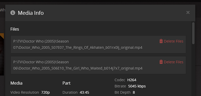

I have a TV episode labelled S06E10 to match TheTVDB but it refuses to match correctly and instead shows up as a duplicate for S07E07. I can’t find an ‘unmatch’ button that works on an individual episode for some reason. I’ve done the Plex dance (moving files away, scanning libraries, cleaning bundles, moving them back, scanning libraries again) and it keeps doing the same thing. There is metadata built into the actual file, but that all refers to S06E10 and there is no reference of S07E07 in this. All other episodes in this series match correctly and have exactly the same filenaming structure. TheTVDB doesn’t appear to have any issues with this particular episode.
If anyone knows how I can rectify this properly (i.e. without manually editing the display in Plex) I am all ears!
Files matched to S07E07:

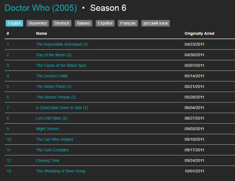

How TheTVDB displays them:

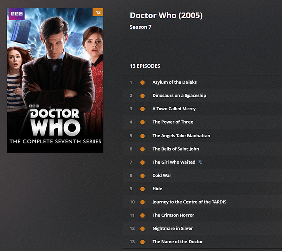

How Plex Web Client displays them (weirdly taking the episode title from S06E10 as the title for S07E07 aswell):

Thanks to anybody who can help! I have a feeling that the iPlayer code in the filename may be an issue as it contains “7x7” but I would have thought Plex would be reading the filenames from left to right, not right to left.
I would also guess its getting confused by the 7x7 at the end of the series 6 filename (you could try removing this first if you dont want to fully rename, or place this inside square brackets which i think causes it to be ignored)
Personally i would rename them to
P:\TV\Doctor Who (2005)\Season 07\Doctor Who (2005) - S07E07 - The Rings of Akhaten.mp4
P:\TV\Doctor Who (2005)\Season 06\Doctor Who (2005) - S06E10 - The Girl Who Waited.mp4
I have series 7,8 & 9 and the aboce naming works without issue
Thanks. I tried square brackets but it didn’t seem to ignore the code. This is unfortunate as I was trying to keep everything after the episode number the same as the original filename so that I can easily identify the source, should I wish to find a better quality version in the future. For now I’ve just had to remove the code and it does identify the episode properly. I’m sure I read that Plex Scanner ignores everything after the episode number. :confused:
I think this might class as a software bug of some kind. What if in the future this sort of thing is in an episode title? “ABC - S07E03 - 2x2 equals 4”? Would that identify as S07E03 or S02E02? A little bit annoying…!

Just FYI, the issue did turn out to be the “b014j7x7” iPlayer code in the filename, it was picking up the 7x7 at the end. I had heard that Plex ignores anything after the episode number so left the remaining data in the filenames the same to help with source upgrading in the future - but obviously this is only the case if I use the recommended naming scheme with hyphens.
