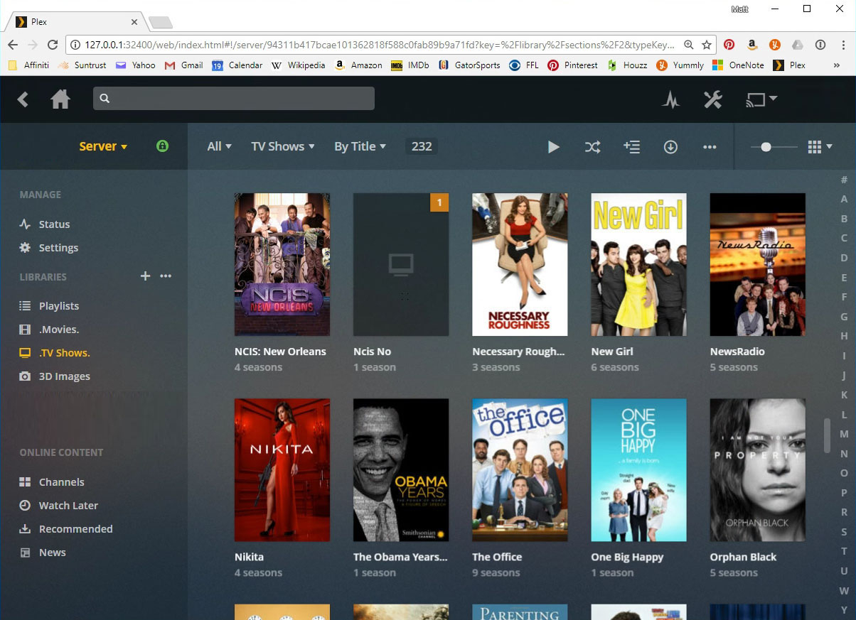

I am adding a screen grab to show how the episode incorrectly sits next to the series it is suppose to be a part of.
Nice Screenshot - that shows nothing about the likely cause of the issue - only shows the result of the issue.
Try a screenshot of your Windows Explorer layout for the TV Show file names and structure - then we’ll see what’s up.

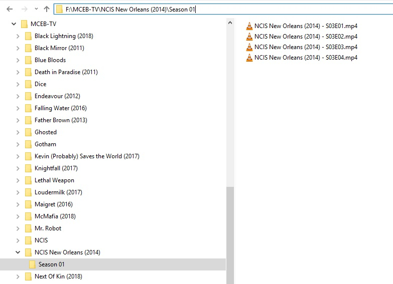

Appreciate the inquiry for additional info, attached is the zip file of the logs, as well as an additional screen grab of files. What is odd to me is that i have been using plex for nearly 2 years? with the same exact setup, and never had this issue with everything that i have been able to load into it.

screenshot appreciated - and truncated…
The bottom line is that the name of the show at TVDB is:
NCIS: New Orleans - TheTVDB.com - NCIS: New Orleans (we’re going to simply drop the illegal “:”)
NCIS New Orleans
(1080p - HD) is totally acceptable (I do it myself), but it should go in [Brackets] 'cause Plex ignores stuff in [Brackets] - that could make your file name non-compliant.
