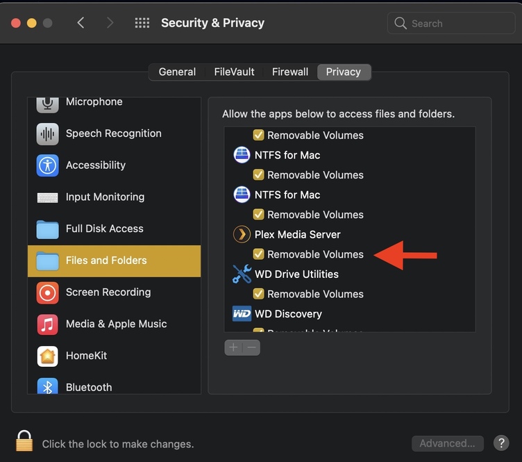

So now have you checked your Security settings.
Checked, and the box was indeed checked.
I’m curious about the Full Disc Access choice. Somebody mentioned using that, but it then shuts off the other selection.
