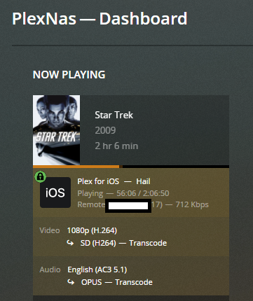

I went ahead and checked my mobile device and was able to access it remotely at this time via LTE. Also tried with tablet connected via Mobile hotspot and it seems to be reachable.
