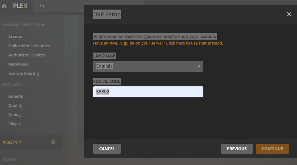

trying to help some one setup a new plex account and they are having the issue with getting the DVR Postal code for USA 55802 working it does not move stuck at this screen
I also am having issues in the US. Not being able to set the postal code. Don’t think this issue is just related to the UK.
I tried the US post code and it does work for me. I would need server debug logs covering the failure. Ideally doing this after a restart of Plex Media Server so I can see the start up sequence in the logs
