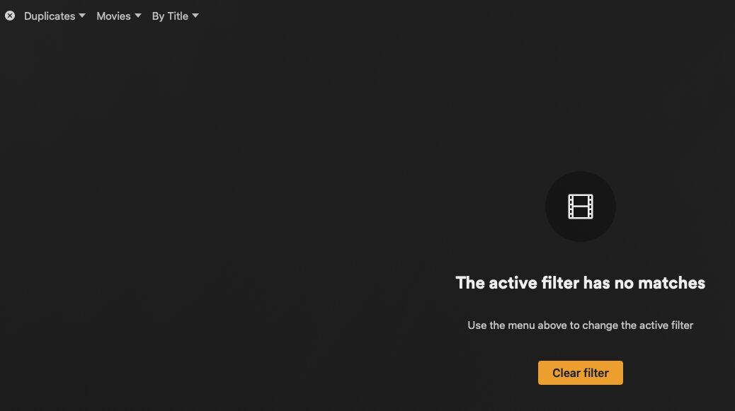

My first suggestion would be to apply the “Duplicates” filter to your library view and see if these new additions are being added as duplicates of existing items.
Aside from that, for matching issues it’s always a good idea to provide a specific example of an item which was not detected (include the full path and file name). For better or worse, the modern scanners/agents are a bit more strict when it comes to adhering to Plex’s naming and organization guidelines.
Thanks, @pshanew.
I don’t have any duplicates in my library.
The issue happens with every new movie I add.
