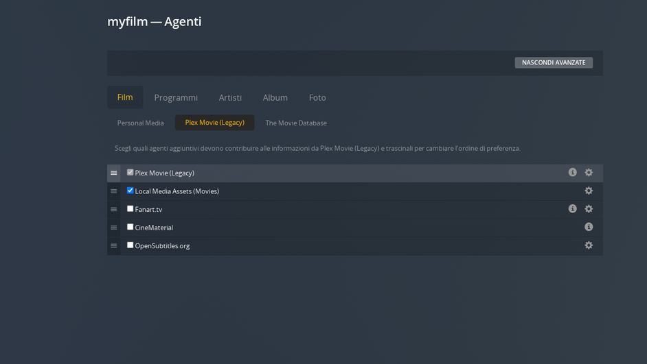

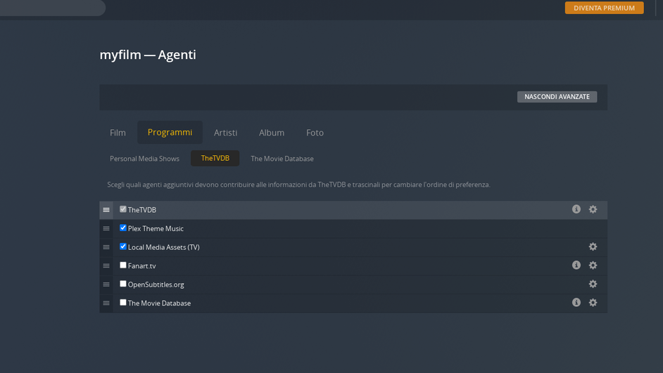

I tried, again, to set the option to view trailers … but I was never able to get it to work. I’ll post photos for you to see how the agents are set up
