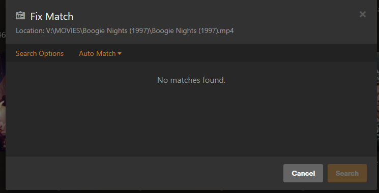

As of about a week ago, I noticed that my Plex Server would only scan for a few seconds whenever I would select to scan the files for my movies. After looking online and trying different settings changes I discovered that if I changed my Scanner to the Legacy version, it would scan and find the new movies but would leave a “!” in my notifications saying that I was using an outdated version for my Plex Server. I thought maybe it was a one off issue and switched back after finding and matching the new movie file but it removed the movie after I swapped back to the new scanner (Plex Media). I have tried other scanners and agents but legacy is the only one that has worked when it comes to scanning for new movies. I have refreshed all my metadata as well. Anyone have a solution for this? It’s very frustrating!

Is there an update to this or a proper fix as of yet? This just started for me over the last 3 days but it is the same error. I tried to switch to the Plex Movie Scanner agent and despite saving and the save working it would revert back to Plex Movie which would yield no results in matching media so I am adding details manually which is stupid. I’ve been on the fence for a couple years for trying jellyfin, but this may be the final push to look at their media server. Any and all help would be welcome. I am running Version 1.41.6.9685 on a Windows Server.

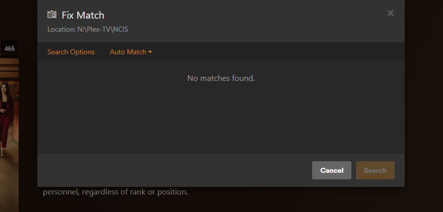

Any update to this? I have several movies and TV series waiting to be matched. Oh yes, and subtitles have stopped being found when searched for.
