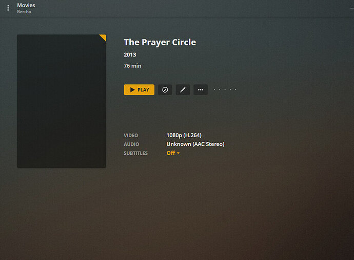

Whenever I “match” a movie using the new~ish Plex Movie Agent (not the Legacy one) I get no movie poster, no information, no cast or director, no description or ratings or similar movies or anything. It says it’s matched, but no info shows up at all.

Don’t know how you have the movie named but here’s my result with the new movie scanner:
And here’s how I have the file named:
The Prayer Circle (2013) {imdb-tt2550988}
Movie length is probably incorrect as I used a sample file instead of a copy of the actual movie.
The power of the new movie agent lies in the ability to add an imdb ID or a tmdb ID. I couldn’t find this movie in the Movie Database so I looked it up in the IMDB and found the tt number from there.
It found/matched the movie almost immediately when I selected Plex Movie as the search agent and it had a description/poster in the search results. It just never added any of that info to the movie itself.
This has happened with every movie I’ve tried (a couple dozen, to be sure).
The.Prayer.Circle.2013.1080p.WEBRip.x264.AAC-[YTS.MX].mp4

Check that your library is properly upgraded
@pandas I had not, thank you, I didn’t know that was required.

Is this in a new Library, that is configured to use the Plex Movie scanner and agent? (Or you’ve used Upgrade Matching to migrate to the new scanner/agent?)
Or is this in an old Library, that is still configured to use the Legacy Plex Movie Scanner scanner and Plex Movie (Legacy) agent?
You can’t really mix & match successfully - when doing a Match or Fix Match you need to use the same scanner that is configured in the Library.
If you’re still using the old scanner/agent, you can manually Fix Match and search for 2550988, using the Plex Movie (Legacy) agent. That works for me, although I don’t get a Poster.
I would encourage you to Upgrade Matching on your Library, if you haven’t already.
I would also encourage you to name files appropriately, per the guidelines.
The Prayer Circle (2013).ext matches immediately w/ the new agent, and gets good metadata (as shown by others above).

Prayer Circle was the first thing I tried and it fixed itself perfectly with a manual refresh.
