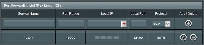

I need to forward port 49000 to my Plex server bcs I can’t use 32400 on my service, and when I got to my Asus RT-AC66U and I made this:
But Plex ain’t really happy about this:
I am doing anything wrong here? I other ports open without any problems but I just can’t seem to get Plex to open up.
Assuming the Local IP on the Port Forward is the Private IP for the server and the server has one LAN interface then it should be ok - but there are many potential issues that would stop remote access working. See the Troubleshooting Remote Access page for the checklist https://support.plex.tv/hc/en-us/articles/200931138-Troubleshooting-Remote-Access

Plex does not listen on 49000 but listens on 32400.
The router forwards 49000 to 32400

As far as I can see the public IP that plex.tv sees for remote access to the server is the 195.192,xx,xx IP and not the 77.247.178.202 you tested
This screenshot shows I successfully connected to your server’s 195.192.xxx.xxx IP address through public port 49000
