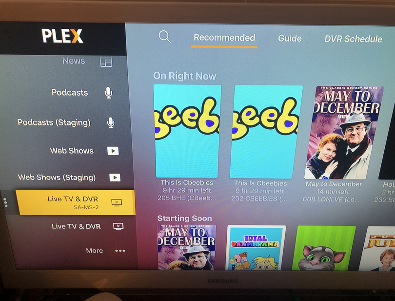

I have just tried the last Apple TV Plex App beta Plex 2.4 (12618) and with 2 Plex Media Servers each with a DVR.
With the UNO release - announced in this forum post https://forums.plex.tv/t/apple-tv-beta-with-uno-ui/393124?u=sa2000 , you have the ability to select and pin to the sidebar Live TV & DVR access to more than one server and the server you select for this does not have to be the same server for other media sources
In this example on my screenshot, you can see I pinned to the sidebar two different DVRs - from 2 different servers. You pin it with a long press and then confirm
If you continue to have problems and the wrong Live TV and DVR selected - then please let me have some details.
