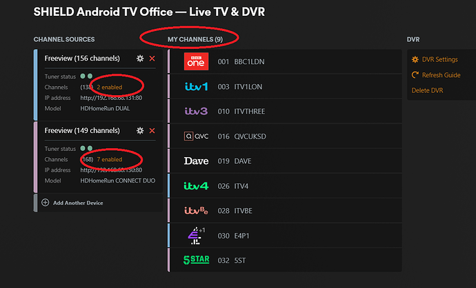

I did a quick test and initially only one of channels showed up - ones from one lineup only
I managed to get both sets of channels (channels from 2 lineups) to show up in the guide by going back to DVR Settings and for each lineup - clicking on the x enabled link and checking that the tuner channels were mapped to guide channels and I noticed they were not and so I re-mapped them and at the end - all combined channel sets showed up
I will look further - but could you try this out and see if it circumvents the problem

Your picture shows that you have configured (2) tuners with a unique postal code/lineup assigned to each unique tuner.
That is a different configuration that what I have.
