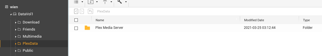

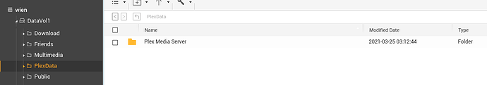

Thanks Chuck. I thought it was simple as well but nothing is showing up in my shared folder. I’m attaching some images to explain where I’m at.
Files visible
Oh no!
Nothing that complex!!!
You’re thinking of PMSLibShare. PlexData doesn’t work that way.
Everything here is dynamic with exception of the anchor point in /share
Let QNAP create it for you. Don’t strong-arm it.
When you do, it shows up as /share/PlexData in the file system.
This is what I’m looking for.
I follow it from there to where it really is.
I do it this way to support “Migrate To” (QTS App Center feature).
PMSLibShare can’t follow Plex. It’s a fixed folder definition pointing to the path at that instant in time.
I’m dynamic and discovered at PMS start.
