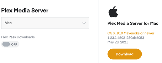

v1.23.1.4602 is the current release:

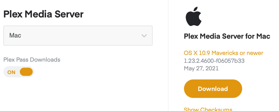

v1.23.2.4600 is the current beta test version (aka Plex Pass download):
Both are absolutely available for download form https://Plex.tv/download but you need you make sure you have that “Plex Pass Download” switch flipped correctly.
You also need to check which you have selected on your PMS in settings:
Screenshot 2021-05-30 at 22.49.26

OK, I just saw your screenshots. For some reason I thought those were ads in the thread and ignored them.
I just went back and saw what you’re talking about.
I have a lifetime Plex Pass, so I assume that’s the one I should be using on my QNAP?
If so, then I’m up to date.
Plex Pass just means you have the honour (?) of beta testing their stuff for them. I would recommend you switch that off.
As I wrote, the latest “production” release is v1.23.1.4602, and that’s the version you want to use.
