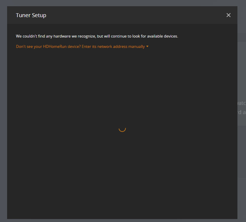

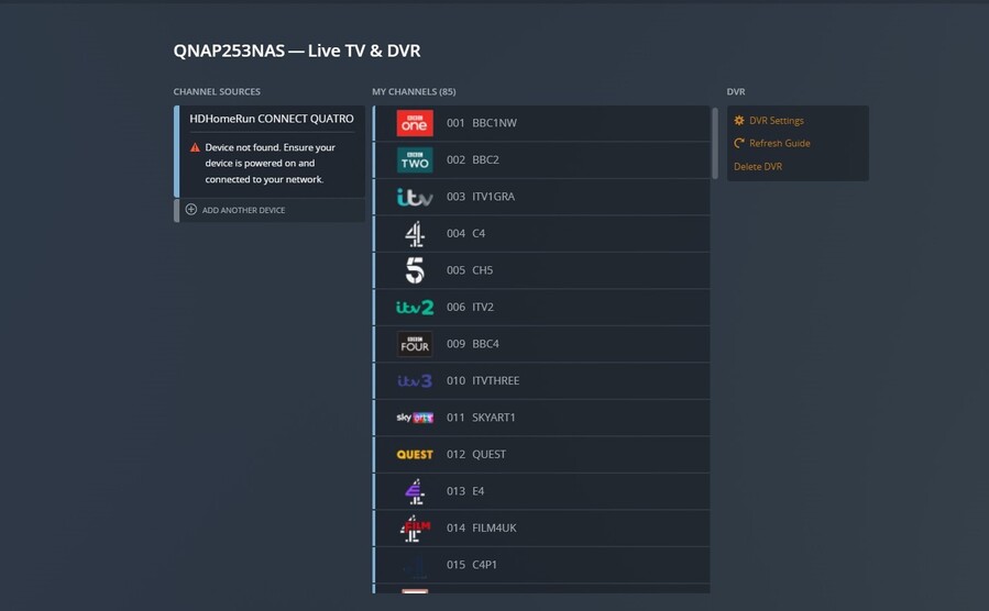

But then wanted to scan for more live TV channels as a lot was missing I then noticed that the Live TV & DVR was complaining that “device was not found check the device is connect on the network” All the channels were working through the HDHomerun app and home page but whilst I still had a TV guide, Live TV wouldn’t play or record on the Plex, I powered cycled HDHomerun and I uninstalled Plex and downgraded the server back to 1.44.0.2981-e2d72ac2, but still got the same issue, I then used a QNAP snapshot from the previous day where TV recordings had been working to see if that worked but still no joy. Both times it said found an unclaimed server so I claimed this server. I’ve scanned for another device but no device found, any ideas as I’m not really sure where else to go with this any help would be greatly appreciated?

Yes that is the correct ip, I’ve installed plex on another machine under another test name thinking maybe it was something that is cached in my soulman247 name, and this installation detects the hdhomerun straight away, please see attached file that works, only trouble is test user hasnt got plex pass. very strange, on the QNAP Plex when I go to add tv device it doesnt find it, Ive tried adding the 192.168.1.99:80 manually and 12522737, HDHR-12522737, http://192.168.1.99:80. Thinking its my DNS Cache I’ve tried clearing it and stop and starting it on windows 10?

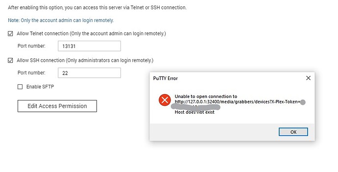

Hi I found the token following the ref above albeit it was to a home video file mpg (nothing to do with DVR) , inserted it to using Putty. http://127.0.0.1:32400/media/grabbers/devices?X-Plex-Token=??? ignored the Curl and <> as in your syntax and got an error, (see attached) so tried another files token same error. Then made sure again that antivirus, Firewall was off the Windows PC, that
Telnet and SSH connections were accessable, disable users & i/p lock outs on the QNAP just in case
Tried http://192.168.1.99/discover.json (Unable to open connection to http host does not exist

You are using putty wrongly, AFAICT
  1. IP of QNAP
  2. Use 22 as port
  3. Make sure SSH is selected
  4. Press Open
If a security alert is shown, select Accept
For user name, use admin and for password Admins password
If you see above, select Q
Then you are in a terminal, and can type your curl commands
