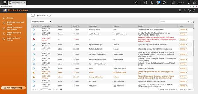

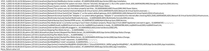

Hi all, I was wondering if you could help me with an issue I have been having over the past few weeks, please.
Around once or twice a day/every few days, my QNAP NAS (TS-453B) randomly restarts. I have attached images of the notifications/log entries that I get.
I use my NAS purely as a Plex Media Server. I have tried downgrading to a previous firmware, but still the same issue.
I have also ran the file check each time with no errors, but it keeps happening.
I am running 16GB Crucial RAM (2x8GB). I have also tried each 8GB RAM stick individually and still had the same issue both times.
I submitted a ticket to QNAP along with logs, who said it was Plex related, but couldn’t really help much further.
