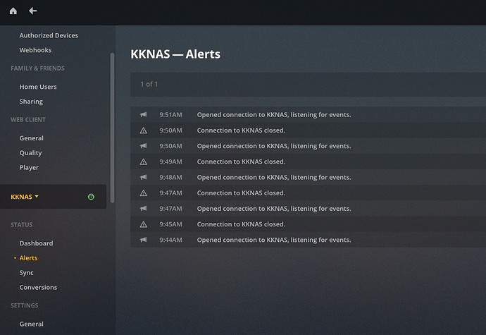

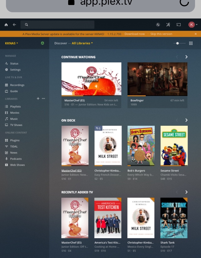

In a bizarre twist, I can access the QNAP server from my phone, but from my laptop it intermittently cuts out like it is now… ugh. See image (will try to upload another image in a second)

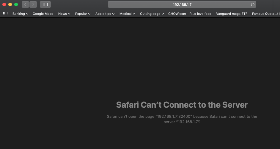

What happens when you try accessing Plex on your QNAP directly.
http://Qnap.Ip.Address:32400
server not found

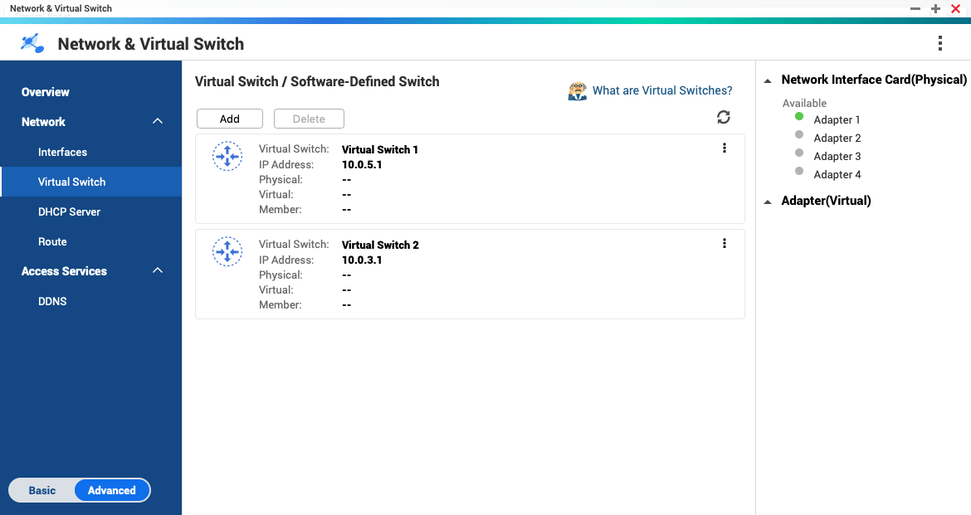

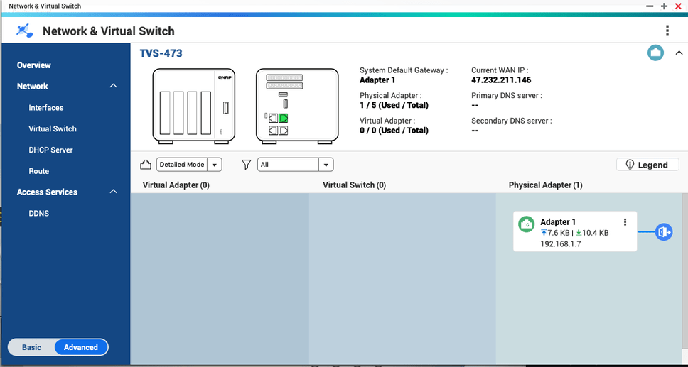

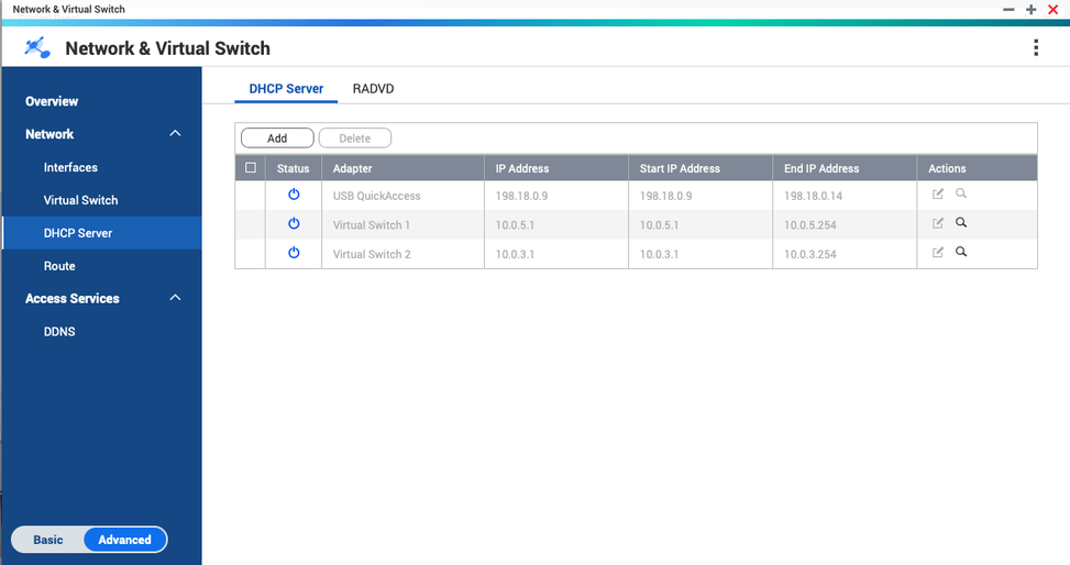

Please show screenshots from your QTS NW & vSwitch pages (detailed view) and your NIC view showing ip/etc.
Will try to get those to you ASAP. (I’ll plumb around the settings / configuration pages to try to find the appropriate info). Safe to assume NW = network?
Hello @MwC_Trexx, I have attached (hopefully) the right screenshots.
I think this is more of a QNAP issue, because for the past ~3 weeks it has been dropping connections frequently. Only randomly could I get in right now to get these screen shots.
Many, many thanks in advance for any guidance you can give.
Your empty DNS servers are likely the cause of your problems.
