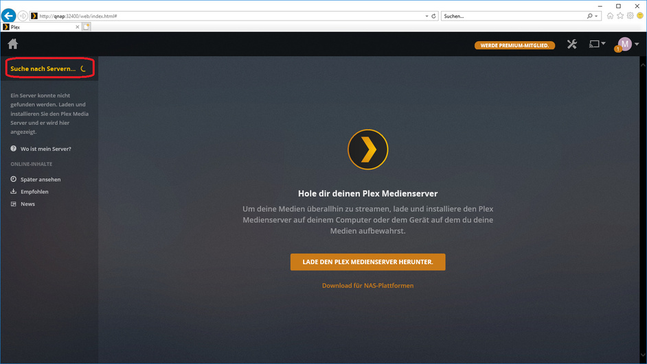

Hello Guys,
since some month I´m looking for a solution getting my Plex Server running.
I have a QNAP TS-451 (OS 4.3.4.0551) (Intel Dual Core 2.4 GHz) and reinitialized it complettly on April this year. I setup a new NAS configuration and I also installed the Plex Media Server 64 Bit Version 1.12.0.829 you can download direktly from the QNAP download center.
But when I opening the Plex GUI the server can´t be found or configured.
Screenshot attached:
The sentense “Suche nach Server” means “Searching for Server”.
I spend a lot of hours and tried several solutions I found in the web on differend forum´s.
I also tried the solution steps from Plex itself but it doesn´t helped me further.
https://support.plex.tv/articles/204604227-why-can-t-the-plex-app-find-or-connect-to-my-plex-media-server/
I created a second Plex Account and used him for the PMS login to be shure that nothing is wrong with my primary account but it hasen´t helped.
After the reinitialisation I did not install many software or apps. I only installed Plex Media Server and Malware Removal Tool. So I´m talking about a very fresh and clarity system.
I used my Plex server in the passed with OS 4.2. very well but now I don´t know whats wrong with my system?
If anybody have a hot tip for me that would be very nice.
Thanks and greetings Mr_NoGood

Hi ChuckPa, thank´s a lot but it doesn´t.
I have no problem having access the Plex GUI.
I know the problem between HTTP and the wrong HTTPS link.
The URL I´m using is http://qnap:32400/web/index.html#
As you can see in the screenshot I´m on the Plex Webside.
Normally you could see the server settings on the left where you can edit the directory path for your movies etc…
But without a server there are no settings?

Hey ChuckPA,
we fixed it. You shown me the problem with the unrecognized domain!
I´ll explain it in more detail:
I have a local router with a DNS-Server and added a entry in the past for the name “qnap” that resolve to the local IP 192.168.20.200.
So you had only to type qnap in your browser to reach the QNAP webinterface.
If you now use the Plex link in your QNAP webinterface a new tab will open with the following URL:
Works not ------------------------------------------------------------------ ------------------------
And that is the problem. I don´t know exactly why but it is.
You could see the Plex Web GUI but not the server / settings!
Works -----------------------------------------------------------------------------------------------
So if you replace the resolvable name “qnap” with the local IP the dashboard works fine and you can configure your PMS as you wish.
http://192.168.20.200:32400/web/index.html#
For those how have the same problem, please use the IP from your QNAP not my. ; )
It´s a bad trap, because the network and QNAP was configured right and you could see the Plex GUI but the server wasn´t found.
Anyway, we made it. Thanks a lot ChuckPA, you are the man of the day. ; )
